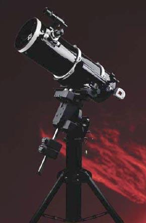

Publicado 28 de Enero del 201213 a Hola a todos, La EQ8 empezo a mostrarse, por la imagen es practicamente igual a la montura que tuve oportunidad de ver el año pasado. La carga maxima de la EQ8 son 50 kgs, mas que suficientes, podes hacer fotos con un tubo de 300 mm y guiar con otro tubo de 300 mm al lado Como les comente en otros posts, este modelo no es parecido en nada a la supuesta EQ7/EQ8 que esta circulando por la web, es un modelo totalmente distinto. La foto puede resultar medio mentirosa, ya que las patas del tripode que ven ahi son de 3 o 4 pulgadas de diametro. Aqui va el detalle tecnico de la montura Dual Encoder Design With the patented dual encoder design, you may move the scope to any position manually or electronically without deactivating the tracking mode first. After moving to a new object, the telescope will automatically begin to track the new object accurately. No re-setup is required in one observing session. The mount is good for remote observatories. Motors It utilizes 0.9 degree per step bipolar stepper motors to get high resolution. It uses stepper motors without reduction gear to drive worm shaft directly so to remove the periodic error caused by reduction gear. Computer Operation Couple the solidly-built mount with the included SynScan computer controller to utilize many of the same functions and features as Sky-Watcher's most advanced SynScan mounts. It also could be controlled by SynScan Tour. PEC Permanent programmable periodic error correction (PEC) - corrects for periodic tracking errors inherent in all worm drives. Convenient Alignment It could go back to initial position of the telescope automatically, which is convenient for alignment. Superior Stability The EQ8 mount is supported by an improved Super HD Tripod. The tripod is made from the finest rolled carbon steel and can be raised to a height of 1347mm. The tripod uses a dual leg support for maximum rigidity with an upper leg brace to provide an outward preload and a lower leg brace providing inward tension. Stable pillar/tripod design The very massve tripod allows hieght adjustment between 0,75 meter and 1 meter. 50kg Payload Capacity! Saludos y buenos cielos! iOptron CEM70AG, iOptron GEM28ECAskar ACL200, Duoptic ED Pro 60, APO 90, Photo 90 5 elementosQHY600M, QHY294M Pro, QHY268C, QHY183M, QHY5III462CZelaya - Pilar - Buenos Aires - ArgentinaDuoptic - Espacio ProfundoMi Galeria de Fotos IG: @rfcontrerasb
Publicado 28 de Enero del 201213 a Una bestia!, todavia no tiene un precio estimado? A ver si entendí bien, el trípode de carbono llega a una altura de 1,34 m? Y el HD es de High Definition o solo le da mas WOW al nombre del trípode?
Publicado 28 de Enero del 201213 a Autor Hola Eminox. El precio aun no fue informado, no bien tenga la novedad lo anunciaré. El tripode es bestial, para soportar 50 kgs de peso por encima del peso de la montura tiene que ser masivo. Hasta ese momento no habia visto en persona una montura tan grande... es sorprendente. Saludos y buenos cielos! iOptron CEM70AG, iOptron GEM28ECAskar ACL200, Duoptic ED Pro 60, APO 90, Photo 90 5 elementosQHY600M, QHY294M Pro, QHY268C, QHY183M, QHY5III462CZelaya - Pilar - Buenos Aires - ArgentinaDuoptic - Espacio ProfundoMi Galeria de Fotos IG: @rfcontrerasb
Publicado 28 de Enero del 201213 a Habría que ver si en su máxima extensión no pierde estabilidad, estamos hablando de 50 kg!, puedo parar a mi novia sobre el trípode jaja

Publicado 28 de Enero del 201213 a No ahora en serio...ese tubo que tiene arriba que será? un 10"? un 12"? la montura es identica a una CGE no? Excepto un poco más de carga...lindo bicho che...cuanto dolerá por estos lados???? J.
Publicado 29 de Enero del 201213 a Autor Juan, es otro rango de monturas, esta carga 10 kgs mas. Una de las cosas que tiene que mas me gustaron son los dual encoders, ya no te preocupas mas por soltar los frenos, un juego de encoders lee continuamente donde esta la montura con lo que podes moverla sin dramas, y los motores mueven directamente el sinfin, lo que te evitas en parte lidiar con el error periodico del engranaje intermedio. En papel pinta bien, pero como todo hay que ver que resultan los primeros reviews. Del precio ni noticia, espero que sean al estilo Synta. Saludos y buenos cielos! iOptron CEM70AG, iOptron GEM28ECAskar ACL200, Duoptic ED Pro 60, APO 90, Photo 90 5 elementosQHY600M, QHY294M Pro, QHY268C, QHY183M, QHY5III462CZelaya - Pilar - Buenos Aires - ArgentinaDuoptic - Espacio ProfundoMi Galeria de Fotos IG: @rfcontrerasb
